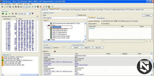

This instruction show you guide on how to use DTS Monaco to turn on the remaining fuel function for Mercedes Benz.
Mercedes Benz Remaining Fuel Liters Coding by DTS Monaco 1
ECU: IC_204
Work with IC_204.cbf with releasedate DATE:15.12.2016 take a look with an editor (for example Notepad) into the CBF file.If you CBF file is older than it could be that you will not have the coding function.
This coding if not done by regular variant coding!!! It is different!
Steps:
1. Connect to ECU IC_204
Mercedes Benz Remaining Fuel Liters Coding by DTS Monaco 2
2. Open tree download
- Choose Entwicklungscodierung
- Change Tankinhaltsanzeige im resierechner fromaus to ein
- Click the check
Mercedes Benz Remaining Fuel Liters Coding by DTS Monaco 3
3. Do a hard reset
Mercedes Benz Remaining Fuel Liters Coding by DTS Monaco 4
